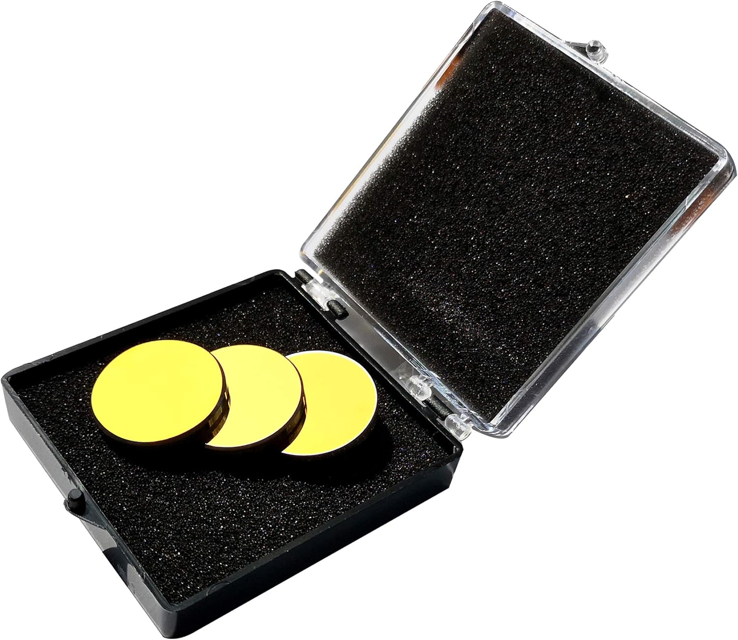

yeah, let me get a set of mirrors and see what happens then? They come on different diameters. I’m assuming the basic K40 machines are 19mm/20mm?
These seem to have the best reviews
K40s typically have 20mm mirrors.
