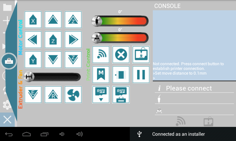

I have just started trialling GCodePrintr on a Nexus 7 (2012) with screen size: 8:5 aspect ratio, 1280×800 WXGA. The side bar on the left has the icons overlapping slightly and I can only see 6 of the 9 macro buttons because the other ones disappear. Is there something I can do to fix this?

I still have this issue, but ive just noticed some of the photos of other peoples tablets show a different interface for smaller screens. Should my Nexus7 (2012) be using this interface so everything fits: https://lh5.ggpht.com/33BMWKr_f3zLPTXCFZNOVLu9aQT4m-rzcZLAxYl2hsAhxHqCmjzqzN1hubA8piFyHw=h900
Because currently it shows this interface: http://fs01.androidpit.info/a/fe/3f/gcodeprintr-the-3d-print-app-fe3fc7-h900.jpg
And it doesnt fit.
The layout depends on the “smallest width” value of you tablet. Long press on the “motor stop” icon prints out the smallest width to the console

SimView size w:1197 H:736
Metrics: DisplayMetrics(density=1.3312501, width=1280, height=736, scaledDensity=1.3312501, xdpi=195.38461, ydpi=200.69136), densityDPI: 213
SmallestWidth:721
CalcSmallestWidth:552.8639
