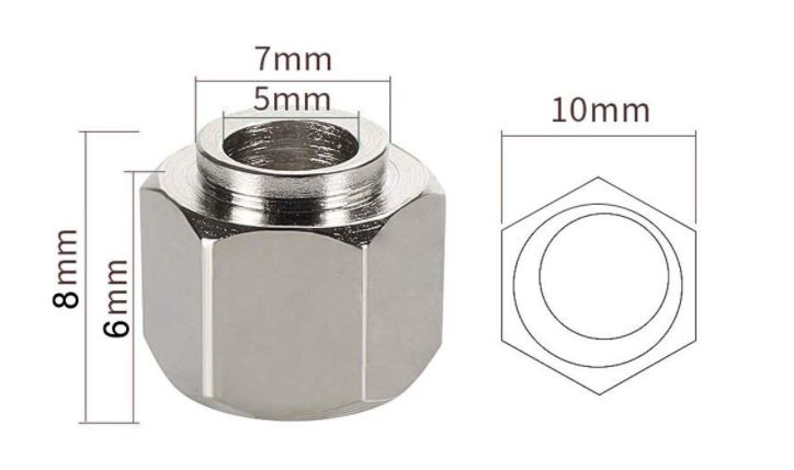

In summary, I fabricated a new bottom plate and added eccentric spacers to adjust out the play between the carriage tires and the V-slot extrusion. Pretty common method.
