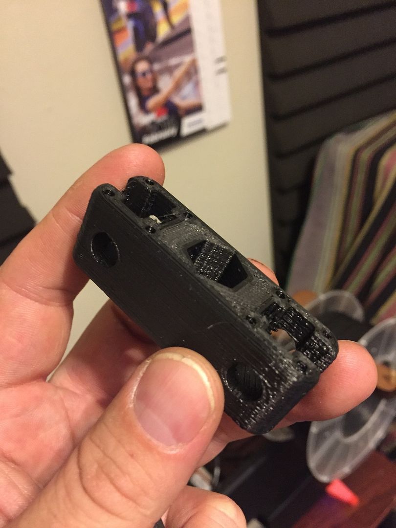

Your infill looks like under-extrusion but the internal perimeters suggest that’s not the case.

So this was an previously unsuccessful print, the power went down half way through the print but this is how I want it printed out.
Here’s a pic of a print that’s just come off that was successful
