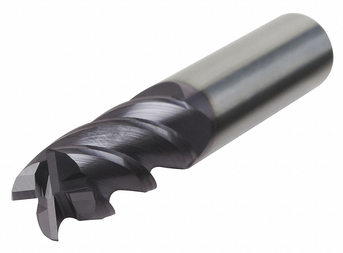

With a 1/2" end mill (per the instruction on github), making the hole after hand-drill the pilot hole was pretty easy.

@Eclsnowman , I had the same problem - tool supply here in the third world is poor - what is the ‘right tool’? I will bite the bullet and ship it from the US.
@Mike_Thornbury 1/2" end mill bit is ideal (or similar clearance metric bit), or a hole saw bit could work too.

I meant an end mill bit like you would use machining: http://static.grainger.com/rp/s/is/image/Grainger/14M956_AW01?$mdmain$
