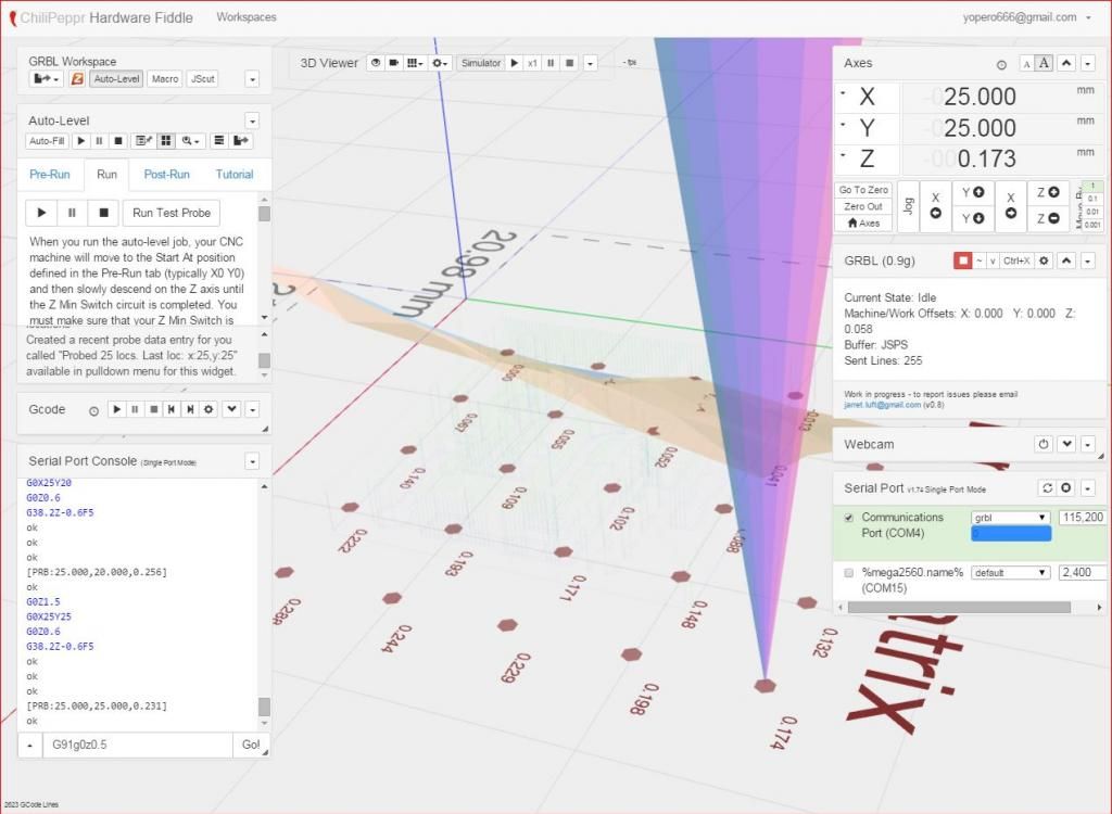

I have just run the autolevel job and I am afraid it is not issuing the G91 command after the probing the last point.
I have left "z final safety height"with the 15mm default and also I use a different one but no joy.
As you can see in my serial port console(picture below) no command is send after the autolevel job is finished.
PD: I have made sure that my Chrome browser was refreshed and I am using grbl workspace http://chilipeppr.com/grbl
hey Jarret
Just after writing my last message I realized you may have changed things on a test repo and not the stable one; So I looked up for your workspace(http://chilipeppr.com/jarret) and voila! it works like a charm from there.
Thanks for your effort!.
