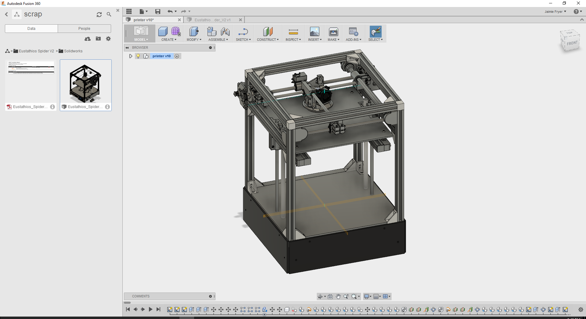

I want to recycle what I have into a smaller Eustathios Spider V2 (320 * 320 * 348 in mm). I’m still not great at CAD but I’ve started to play with a frame that will give me the most volume with the parts I have.
This gives me a few questions though. Which parts will I have to change to fit into a smaller volume? Are there any obvious problems that may come from doing this? What is the smallest distance that I can make this section? (see image)
If you want to test fit into your model fusion360 can import the X_T files on the github very well. If you have questions about fit… Confirming via the model is the best way. That’s why I 100% modeled mine before building. It leaves less up to chance.
You shouldn’t have to change much when it comes to the 3d printed parts, as they aren’t really dependent upon the lengths of the other metal pieces (Rods and extrusions and such). You just need to make sure you make them long enough to handle the desired build area. Modeling everything in CAD first is indeed the best way to go.
