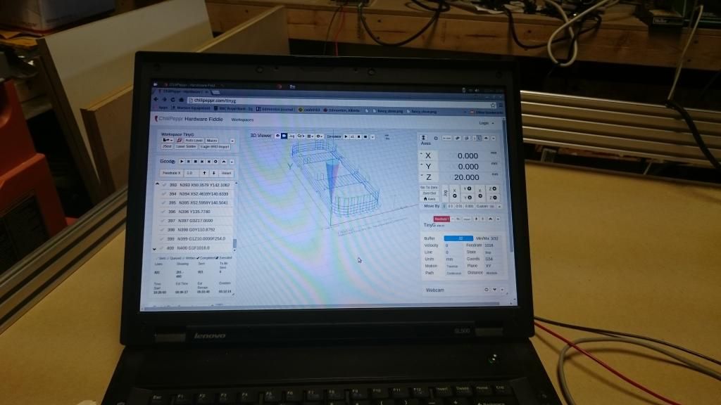

Brian Cross  now running with ChiliPeppr on an older laptop with Xubuntu and his
@Brian_Cross now running with ChiliPeppr on an older laptop with Xubuntu and his Ox.
http://i831.photobucket.com/albums/zz240/briancrossatshawdotca/Ox%20CNC%20Build/DSC_0022.jpg
Yup, and it’s working fantastic! Thanks again John for developing this tool!
Brian
