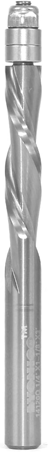

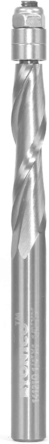

I was on the way to get a top-bottom bearing flush cut single flute bit. With that bit, I could manage cutting direction by flipping the templated piece over.
All the bits below worked excellently.
I have purchased Yonico bits before and have been very surprised at the quality and 1/2 the price of anything else.
